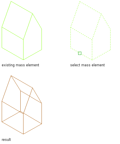

Converting a Mass Element to an Extruded 3D Space
When you convert an extrusion type mass element to a space, it is created as an extruded 3D space. Non-extrusion type mass elements include:
Mass elements that can be converted to an extruded 3D space include:
Note: To make sure that the converted space uses the mass element geometry, verify that the space tool used has its geometry type set to Undefined (--). If it is set to Extrusion, a mass element is converted based on its profile shape and extruded from that. A non-extruded mass element shape, like for example a pyramid, will be converted to an extruded box shape with the pyramid profile.
- Select the mass element that you want to convert to a space.
- Click
- When prompted to erase the original geometry, press ENTER to keep the mass element or enter y (Yes) to erase it.
- Edit the properties of the space in the Properties palette as needed.
