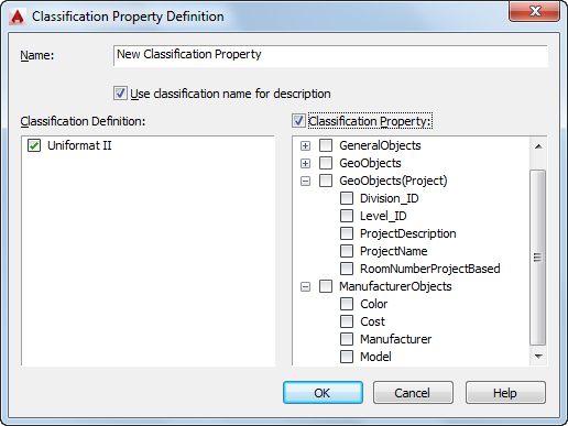

The Classification Property Definition dialog box is displayed. The pane on the left lists classification definitions that apply to the object style for the current property set definition. For example, if the current property set definition applies to door styles, the Classification pane lists all the classification definitions that apply to door styles.
The pane on the right lists all the properties that apply to the classification definitions.
Example of the Classification Property Definition dialog box
The name identifies the property in the property set definition.
By default, schedule table styles use the description for the column heading. The default description for classification properties comprises the names of the classification definition, the property set definition, and the property (such as Vendor - Vendor Class - Delivery Date).

Selecting a classification property
To change the name of the property definition, double-click the value for Name.
The format you select becomes the default format of a column when this property is added to a schedule table style. It can be changed at any time. The Example column shows how the default value is displayed using the selected format.
