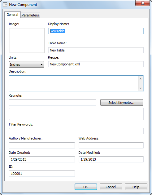

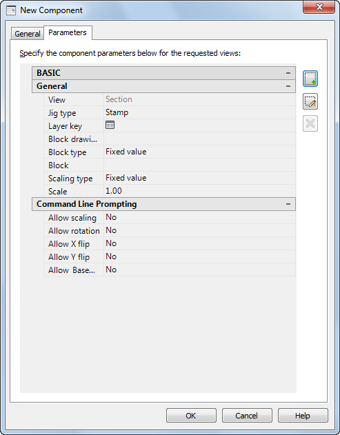

Use this procedure to add a component to a detail component database and create a blank size table to which you can then add rows representing the sizes in which the component is available. When you add a component, the values you specify on the General and Parameters tabs of the New Component dialog box are used to create one or more recipes for drawing the component in different views. Each recipe specifies the type of jig, or drawing routine, for placing the component in a specific view. The recipe may also contain information pertaining to layer and hatch pattern.
. The New Component dialog box is displayed.
| Value Name | Description/Instructions |
| Image | Right-click the Image box, and click Specify Image to browse images available for the selected group in the location specified by its Path Key value. The image you select will be displayed on the Image tab of the Detail Component Manager when this component is selected. |
| Display Name | Enter the name you want displayed for this component in Detail Component Manager. |
| Table Name | Enter the name of the size table for this component. |
| Units | Select a unit from the drop-down list. |
| Recipe | Enter a name for the RecipeSpec XML file to contain the recipes you specify for drawing this component. |
| Description | Enter the description you want to display for this component on the Information tab in the Detail Component Manager. |
| Keynote | Click Select Keynote to browse for or create a keynote to be the default for this component. |
| Filter Keywords | Enter a comma-delimited list of keywords to be used in searching for this component. |
| Author/Manufacturer | Enter the name of the person or other entity responsible for this component. |
| Web Address | Enter the URL for the author/manufacturer. |
