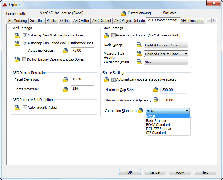

public class AecSpaceOffsetStandardSample : AecSpaceOffsetStandard
public AecSpaceOffsetStandardSample()
 The AecSpaceOffsetStandard.SetName() method is implemented in the base class and cannot be overridden. It needs to be called to register a name for the standard in the constructor of the class. This is the name that will show up in the list of available area calculation standards in AutoCAD Architecture.
The following example shows the call for the sample project AecSpaceOffsetStandardSample which registers itself in the software as the Basic area calculation standard.

 Each of these calls will return a reference to an object of the Autodesk.Aec.SpaceOffsetRulesManager.AecSpaceOffsetRuleCollection class, which exposes functions to register the different rule types. These objects are maintained and used by AutoCAD Architecture. The following example shows how to register rules with the 3 different offset types:
