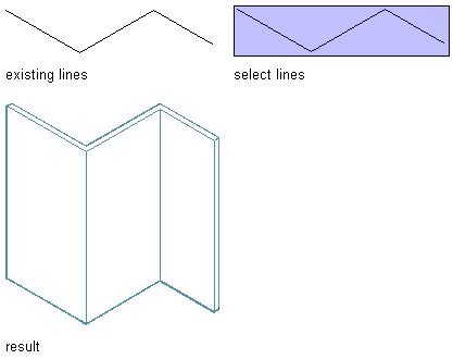

To Convert a Line into a Wall
- Right-click a wall tool, and click Apply Tool Properties to
Linework.
- Select the line to convert, and press Enter.
- When prompted to erase the original geometry, press Enter to retain the linework, or enter y (Yes) to erase it.
- Edit the properties of the new walls in the Properties palette, if necessary.

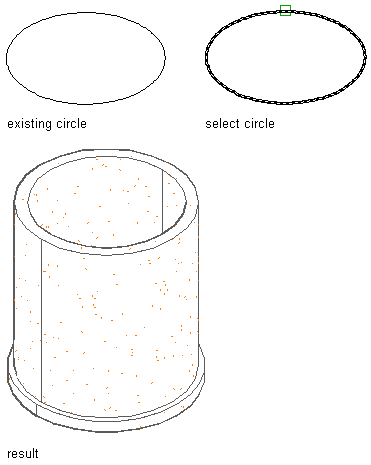

To Convert a Circle into a Wall
Linework.
- Select the circle to convert, and press Enter.

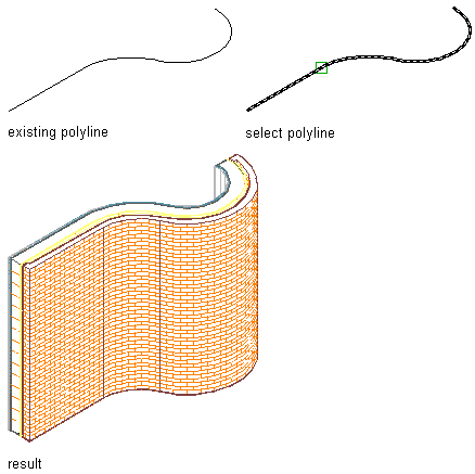

To Convert a Polyline into a Wall
Linework.
- Select the polyline to convert, and press Enter.

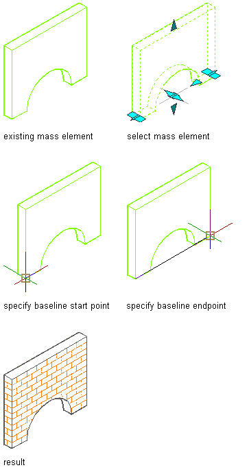

To Convert a 3D Object into a Wall
Convert a 3D object, such as a mass element or an AutoCAD ACIS solid, into a single-component wall.
- Select the object you want to convert to a wall.
- Click
- Enter y (Yes) to erase the original object, or enter n (No) to retain the object.
- Specify the baseline of the wall:
| If you want to … |
Then … |
| specify the baseline of the wall by specifying the start point and the endpoint of the wall |
specify the start point, and then specify the endpoint when prompted. |
| specify the baseline of the wall from an existing line or arc in the drawing |
enter p (Pick), and select the line or the arc you want to define for the baseline. |
Note: Specifying a baseline away from the object you are converting to a wall affects the insertion of anchored objects, such as doors, windows, and openings. Anchored objects are inserted in a wall relative to the baseline of the wall.
- Select a wall style.
The wall style you select must be a single-component style.
