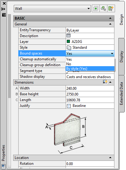

- Select the object for which you want to set the Bound Spaces property, and double-click.
- In the Properties palette, display the Bound Spaces setting in one the following locations:

Expand the General category. |

- For Bound Spaces, select one of the following options:
- By Style (Yes/No): This object uses the Bound Spaces setting defined in the object’s style. This is the default setting for objects that have styles.
- Yes: this object can bound associative spaces.
- No: this object cannot bound associative spaces.
