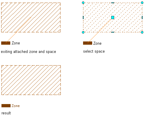

- Select the zone from which you want to detach a space or zone.
- Detach the space or zone in one of the following ways:
- Click the Detach (Minus) grip on the connection line to the attached space or zone.
- Click
Then, select the space or zone you want to detach from the zone, and press Enter.
