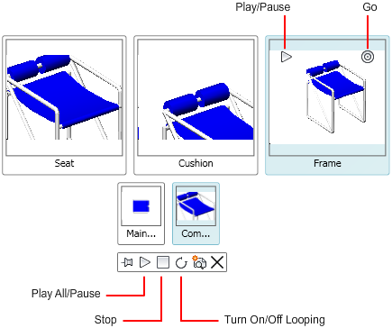

Once a shot is created, you can play back the animation assigned to the shot by using the view controls located on each shot or shot sequence thumbnail or the ShowMotion control. The available view controls are:
  • Play. Starts the playback of a shot or shot sequence. When the cursor is over the thumbnail, the Play button is displayed in the upper-left corner. The Play button plays back the individual shot or all the shots in the shot sequence.
  • Play All. Starts the playback of all shots in all shot sequences. Shots are played left to right, starting with the leftmost shot sequence.
  • Pause. Stops the playback of a shot or shot sequence.
  • Stop. Stops the playback of the current shot.
  • Go. Restores the view of the model assigned to a shot or the first shot in a shot sequence.
