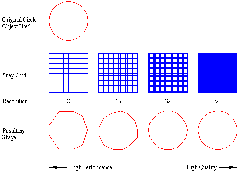

Large resolution values create shapes that are more accurate representations of the selected geometry. However, large resolution values tend to create shapes that contain more coordinate data and place a higher processing burden on AutoCAD during regeneration. Conversely, small resolution values create less accurate shapes that are more quickly processed by AutoCAD. You can experiment with different resolution values to find the balance of performance and accuracy that best fits your needs. Note that the resolution value is rounded off to the nearest factor of 8 and cannot exceed 32,767. The following graphic shows how the resolution factor affects the resulting shape's appearance:
