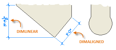

Linear Dimensions
You can create horizontal and vertical dimensions with the DIMLINEAR command. Notice that the button is a drop-down list that includes the most popular dimension commands.
The following illustration demonstrates one method for using the DIMLINEAR command. Once you start the command, press Enter or the Spacebar, select the line (1), and then click the location of the dimension line (2).

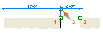

For the 8'-0" dimension below, you can use the other method. You start the DIMLINEAR command, click two endpoints (1 and 2) and then the location of the dimension line (3). To line up the dimension lines point 3 was snapped to the endpoint of the previously created dimension line.
Use the DIMLINEAR command to create horizontal and vertical dimensions, and the DIMALIGNED command to create dimensions that are parallel to an object.

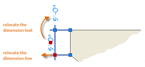

Modify Dimensions
For simple adjustments to dimensions, nothing is faster than using grips.
In this example, you select the dimension to display its grips. Next, click the grip on the dimension text and drag it to a new location, or click one of the grips at the end of the dimension line and drag the dimension line.
Tip: If the changes are more complicated than this, it might be faster simply to delete and then recreate the dimension.

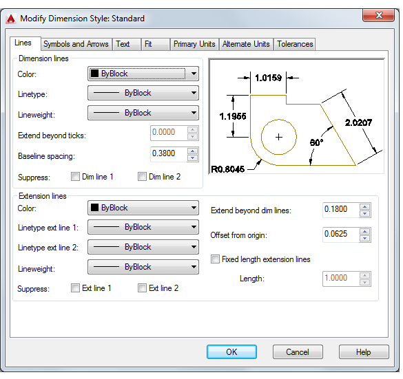

Dimension Styles
Dimension styles help establish and enforce drafting standards. There are many dimension variables that can be set with the DIMSTYLE command to control virtually every nuance of the appearance and behavior of dimensions. All these settings are stored in each dimension style.
The default dimension style is named either Standard (imperial) or ISO-25 (metric). It is assigned to all dimensions until you set another style as the current dimension style.
The current dimension style name, Hitchhiker in this case, is displayed in the drop-down list of the Annotation panel.
To open the Dimension Style Manager, click the indicated button. You can create dimension styles that match nearly any standard, but you will need to invest time to specify them completely. For this reason, you should save any dimension styles that you create in one or more drawing template files.
