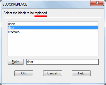

Specify the block name to search for by selecting it in the list or by clicking the Pick button and selecting a block in the drawing:

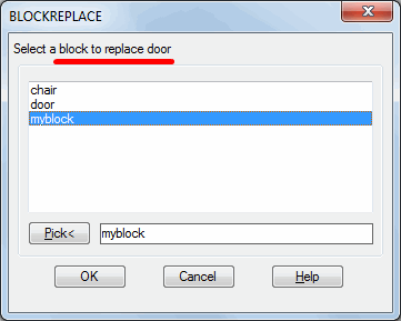

Specify the replacement block:
