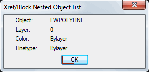

Select an object as a nested block or xref file to display the Object and Block Name, Layer, Color, and Linetype properties.
The pick box identifies the plant as the selected object:
Selecting the object opens the Xref/Block Nested Object List dialog box with the property information shown:
