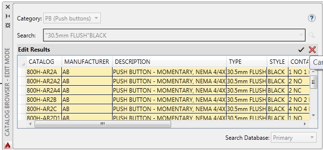

Basic Workflow
  1. If the Catalog Browser is not open, click Schematic tabInsert Components panelInsert Components drop-downCatalog Browser. Find
  2. Select the category you want to edit.
  3. Perform a search to display the records you want to edit.
    Note: Subassembly records are not displayed until you open edit mode.
  4. Click to open edit mode.
  5. Edit, delete, and add content following the steps described in the next sections.
  6. To exit edit mode, do one of the following:
    • Click to save all changes.
    • Click to cancel all changes.

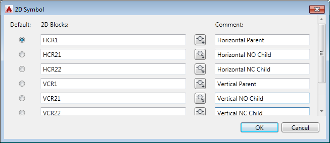

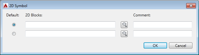

Assign an AutoCAD Electrical Schematic Symbol to a Catalog Value
  1. Locate the catalog record for the symbol.
  2. Click twice on the SYMBOL2D cell.
  3. Click to launch the 2D Symbol dialog box.
  4. Do one of the following:
    • Enter a block name.
    • Click to open the icon menu where you can select a symbol.
  5. Add an optional comment.
    Note: Rows are added as you add symbol names.
  6. Repeat for each block you want to associate to this catalog value. Include both horizontal and vertical versions.
  7. Indicate which is the default symbol. The default symbol is inserted when you double-click a catalog value while in insertion mode.

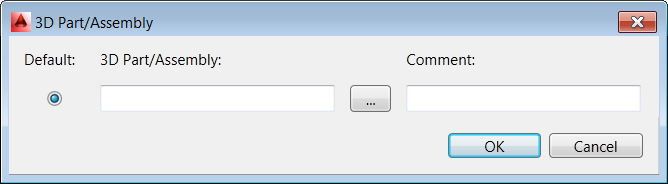

Assign an Inventor Part to a Catalog Value
Note: The AutoCAD Electrical add-in to Inventor uses the parts defined in the SYMBOL3D field. Since the electrical catalog database is shared between AutoCAD Electrical and Inventor, values can be edited in either program.
  1. Locate the catalog record for the part.
  2. Click twice on the SYMBOL3D cell.
  3. Click to launch the 3D Part/Assembly dialog box.
  4. Enter the part name or browse to it.
    Note: Rows are added as you add part names.
  6. Repeat if you have multiple parts you want to associate to this catalog value.
  7. Indicate which is the default part. The default part is inserted when you double-click a catalog value.

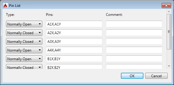

Edit Pinlist Values
  1. Locate the catalog value.

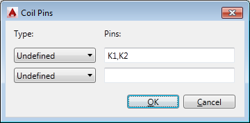

  2. Click twice in the COILPINS cell.
  3. Click to open the Coil Pins dialog box where you define the pins for the parent symbol.
  4. If the parent symbol has a contact state, for example a normally open pushbutton, select the contact type. If the parent symbol does not have a contact state, for example a relay coil, leave it as an undefined type.
  5. Enter the list of pins separated by a comma. The pin values are assigned in the order listed to the TERM# attributes on the component.
    For example, if the value is "K1,K2", "K1" is assigned to the TERM01 attribute, and "K2" is assigned to the TERM02 attribute.

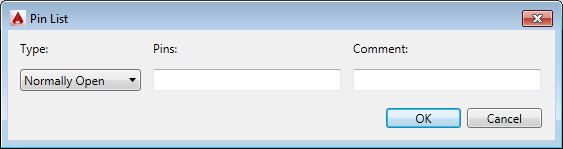

  6. If this device can have child symbols define a PINLIST value.
  7. Click twice in the PINLIST cell.
  8. Click to open the Pin List dialog box where you define the pins for the child symbols.
  9. Select the pin type from the available list.
  10. Enter the pin values separated by a comma or space.
    Note: Rows are added as you add pin values.
  11. Add an optional comment.
  12. Repeat for each set of pins associated with this catalog value.
    The pinlist is written to the database in the format required by the program, for example: 1,A1X,A1Y;2,A2X,A2Y;1,A3X,A3Y;1,A4X,A4Y;1,B1X,B1Y;1,B2X,B2Y;1,B3X,B3Y;1,B4X,B4Y.
  13. If the catalog value can have two parent symbols, for example forward and reversing starters, repeat the steps for the PEERCOILPINS and PEERPINLIST fields.

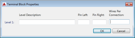

Edit Terminal Properties
  1. Locate the catalog value in the TRMS table.
  2. Click in the LEVELS cell.
  3. Enter the number of levels for the terminal.
  4. Click to open the Terminal Properties dialog where you enter descriptions, pin values, and wires per connection for each level.
    Note: The LEVELS value controls the number of rows available on the dialog box.

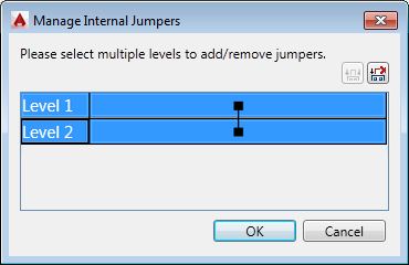

  5. To add or remove internal jumpers between levels:
    1. Click twice in the INTERNALJUMPER cell.
    2. Click to open the Manage Internal Jumpers dialog box where you add or remove jumpers between levels.
    3. Select the rows for the levels you want to jumper internally.
    4. Click to add the jumper.
    5. Select the rows for the levels you want to remove a jumper.
    6. Click to remove the jumper.

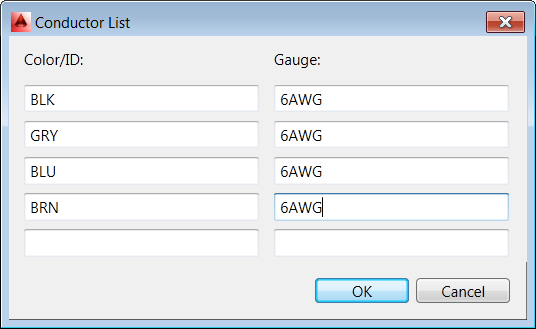

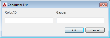

Edit Cable Conductor Lists
  1. Locate the cable you want to edit in the W0 table.
  2. Click twice in the CONDUCTORLIST cell.
    Note: A cable with conductors already defined displays "DEFINED" in the cell. A cable with no conductors defined displays "UNDEFINED" in the cell.
  3. Click to open the Conductor List dialog box where you add conductors and define the color and gauge for each conductor.
  4. Enter a color for the first conductor.
  5. Enter a gauge value for the first conductor.
    Note: Rows are added as you add color or gauge values.
  6. Repeat for each conductor in the cable.
