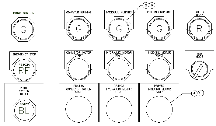

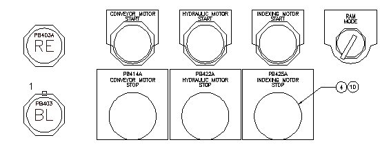

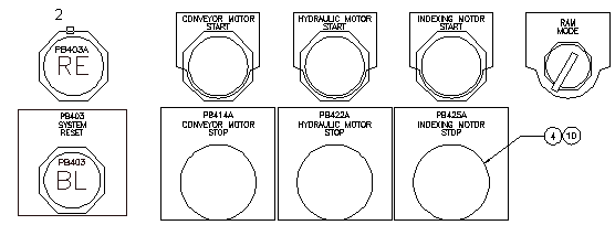

Select objects: Select PB403 (1), right-click to the place the nameplate
As you select each footprint to insert, the nameplate block inserts. The Panel Layout - Nameplate Insert/Edit dialog box displays where you can annotate the nameplate and assign a BOM item number if needed.
In the Panel Layout - Nameplate Insert/Edit dialog box, click OK.
Note: A tag name links the data on the nameplate a tag name to the footprint and to the schematic component of the same name. Changing the tag name of any of these three representations triggers a prompt for permission to update the other related instances.
