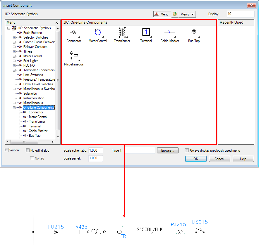

One-line symbols follow the same naming convention as schematic parent and child symbols. To make the symbol names unique, the one-line symbol block names have a “1-” suffix. However, the symbol name does not define the symbol as a one-line symbol. A one-line symbol is defined by the existence of a WDTYPE attribute with a value of “1-” on the symbol, or a value of “1-1” for a one-line bus-tap symbol.
The bus-tap symbol can have two functions:
On a dual circuit one-line template, there are three bus-tap symbols. One at the normal point where the circuit ties into the bus. There is another version of the symbol on each of the two circuit "legs", each marking the point where that part of the dual circuit starts. These bus-tap symbols allow various reports to report accurately on a one-line circuit, whether a single circuit or a dual circuit representation.
The following bus-tap symbols are supplied:
A WDTYPE attribute with a “1-1” value, identifies a bus-tap symbol.
The maximum number of characters for the block name is 32.

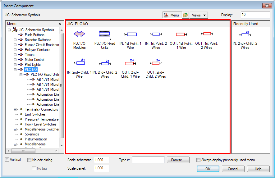

These symbols begin with "HP" or "VP" (horizontal rung versus vertical) followed by a digit 1 through 9. The digit corresponds to the selected PLC module style or look. (1 through 5 are provided in the AutoCAD Electrical library, 6 through 9 can be user-defined).

These symbols begin with "PLCIO" and can be up to 32 characters long. There is no naming convention referenced by AutoCAD Electrical other than the "PLCIO" prefix.
Examples:
PLCIO50E1761-L16AWA.dwg |
AB 1761 model L16-AWA with 0.5 unit rung spacing |
PLCIOI1T.dwg |
Standalone input point, single wire connection |
