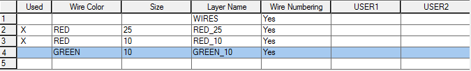

In the Create/Edit Wire Type dialog box, click in the Wire Type #2 row and specify:
Wire Color: RED
The Layer Name is automatically created. The name RED_25 is assigned to the wire layer you are creating.
Click Color.
In the Select Color dialog box, select red and click OK.
Click Linetype.
In the Select Linetype dialog box, select Continuous and click OK.
Click Lineweight.
In the Select Lineweight dialog box, select 0.30 and click OK.
For this example, create three more wire types using the Create/Edit Wire Type dialog box.
In the Create/Edit Wire Type dialog box, specify:
Wire Type #3
Wire Color: RED
Color: Red
Linetype: Hidden2
Lineweight: default
Wire Type #4
Wire Color: GREEN
Color: Green
Note: For pipe runs in P&ID drawings, include the different linetypes from the acade.lin file. You can set up the wire types for pipes at the beginning of the drawing or before creating the pipes.
To set the Linetype for the GREEN_10 wire layer, click Linetype.
In the Select Linetype dialog box, click Load.
In the Load or Reload Linetypes dialog box, click File.
In the Select Linetype File dialog box, select acade.lin and click Open.
Note: The default location for the acade.lin file is \Users\{username}\AppData\Roaming\Autodesk\AutoCAD Electrical {version}\{release number}\{country code}\Support.
In the Load or Reload Linetypes dialog box, select Pneumatic Signal and click OK.
In the Select Linetype dialog box, select Pneumatic Signal and click OK.
In the Create/Edit Wire Type dialog box, click OK.
