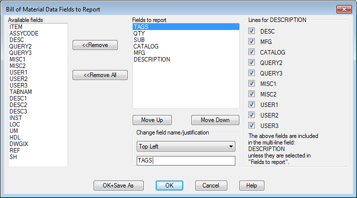

Remove the TAGS columns from the BOM
- Erase the table, or UNDO, and rerun the BOM extract for AEGS03.DWG.
- In the Report Generator dialog box, click Change Report Format.
In the Bill of Materials Data Fields to Report dialog box, Fields to report section, the fields that format the BOM are displayed.
- Select TAGS in the Fields to report list.
- Click <<Remove.
The TAGS field is moved out of Fields to report and into Available fields.
Note: You can also select a field in the Available fields list to add it to the report. You can rearrange columns using the Move Up and Move Down buttons. Clicking Ok-Save As saves these settings to a file for later use.
