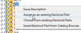

Add the RefDes value from AutoCAD Electrical.
- Right-click PJ2 and select Assign to an existing Electrical Part.
With reference to the AutoCAD Electrical drawing, PJ2 is the RefDes specified for the connector that connects to the motor MOT2, the motor for horizontal adjustment.
- Pause the cursor over the connector occurrence 900575:2 in the graphics window, and note the tooltip.
You can select the occurrence in the browser; however, when you use the graphics window, Inventor displays a tooltip. The tooltip shows the RefDes for that component. The question mark (?) indicates that the RefDes is not yet assigned.
- Select the connector.
- Click OK in the Select Electrical Part dialog box.
- The RefDes specified in AutoCAD Electrical is assigned to the Inventor connector, and the issue associated with PJ2 is removed. Because the dialog filter is set to show only items with issues, PJ2 is not included in the list.
