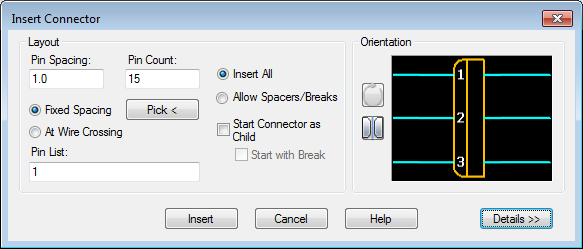

. Find
Pin Spacing: 1.0
Pin Count: 15
Fixed Spacing
Pin List: 1
Insert All
The preview looks like the following image.
A preview outline of the connector displays for placement on the drawing. It shows rounded corners for the plug side of the connector. An “x” indicates the insertion point of the connector. An arrow indicates the plug side wire connection direction for plug/receptacle or plug-only connector inserts or shows the wire connection direction for a receptacle-only connector insert.
