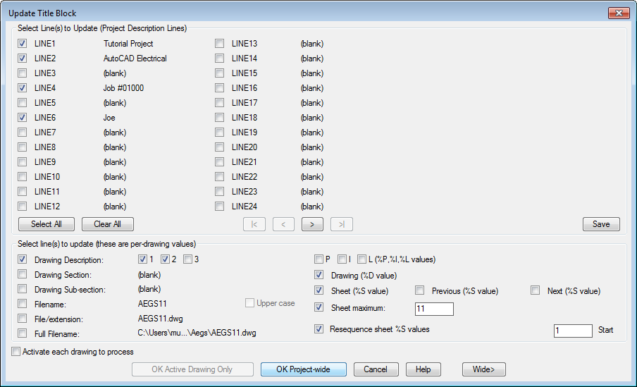

The Update Title Block dialog box displays.
- Select the project and drawing values to update on the title block.
- LINE1
- LINE2
- LINE4
- LINE6
- Drawing Description: 1 and 2
- Drawing (%D value)
- Sheet (%S value)
- Sheet maximum
- Resequence sheet %S values: 1
- Click OK Project-Wide.
- Select drawings AEGS01 through AEGS05, and AEGS11 to process. Click Process v.
