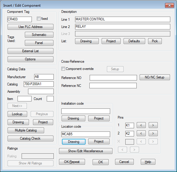

AutoCAD Electrical automatically determines the unique tag name for the new relay based on the line reference location that you inserted the symbol on. “CR” indicates that it is a control relay and “403” indicates that the symbol is on line reference 403. If you inserted this symbol on line reference 404 then the tag name would be “CR404.”

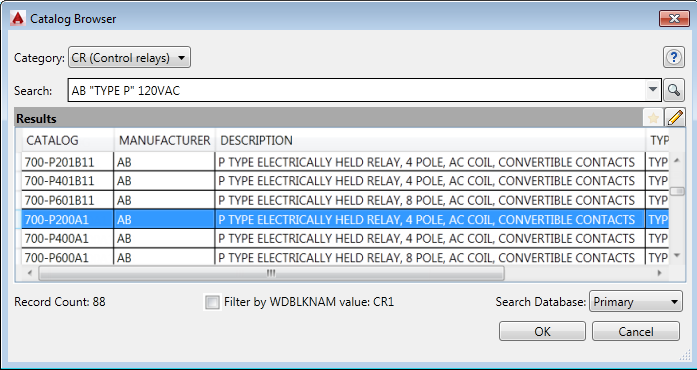

The selected manufacturer code and catalog number display in the Insert/Edit Component dialog box. When you click OK on the dialog box, the values transfers to the symbol.
Line 1: MASTER CONTROL
Line 2: RELAY
Up to three lines of description text can be entered as a description for components. If the third description line is unavailable, the symbol does not carry an attribute for a third line of description.
AutoCAD Electrical does a quick read of the drawing file and returns a list of all location codes used so far.
Pins: 1: K1
Pins: 2: K2
Any values entered here are saved as attribute values on the symbol itself.
