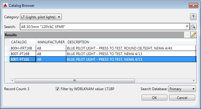

Use search to display catalog numbers selectively for a component type.
Search catalog data
- Right-click LT410 and select Edit Component.
- In the Insert/Edit Component dialog box, Catalog Data section, click Lookup.
- Enter the search AB 30.5mm "120VAC XFMR" and click
- Change the catalog assignment to 800T-PT16E.

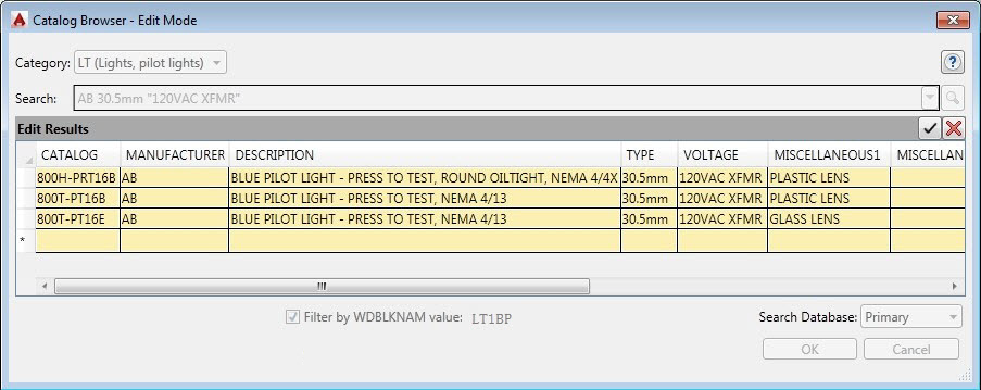

Add a catalog entry
- In the Catalog Browser dialog box, click
to start the edit mode.
- Right-click on the row for catalog 800T-PT16E and select Copy row.
- Right-click in the blank row at the bottom and select Paste.

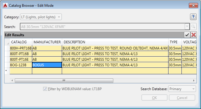

- Click the Catalog cell and enter BOG-123B.
- Click the Manufacturer cell and enter BOGUS.
- Click
to save the changes.
- Change the search to BOGUS 30.5mm "120VAC XFMR" and click

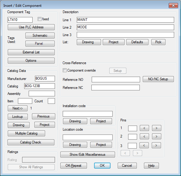

- Select the BOG-123B catalog entry and click OK.
- In the Insert/Edit Component dialog box, click OK.
