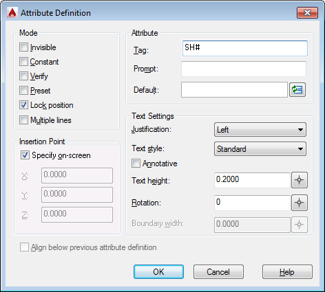

- Enter ATTDEF at the command prompt to insert attribute definition objects.
Note:
When the border drawing is inserted as a block on another drawing, attribute definition objects become attributes.
- Enter the Tag name SH#.
- Set any other attribute definition properties and values, such as text style, height, and justification.
- Select OK.
- Specify the insertion point.
- Repeat for each attribute definition for the title block as shown.
