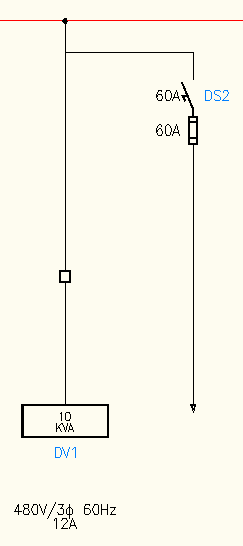

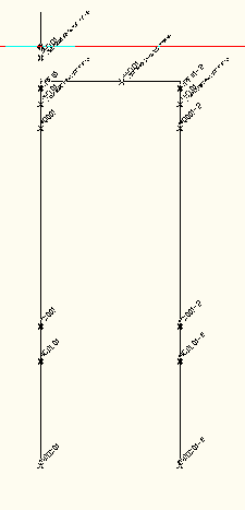

The Circuit Configuration dialog box displays. Notice that some circuit elements have a “(2)” prefix. These elements make up the second circuit in the dual circuit.
In the Circuit Elements section, select Load Setup.
In the Setup & Annotations: Load Setup section, select the Browse button.
The Select Load dialog box displays.
Select Type: Transformer, Voltage (V): 480, and Phase: 3.
Select an entry from the grid and click OK.
Continue selecting Circuit Elements for the first circuit:
Load: Generic box
Disconnecting means: None
Terminal strip or connector: Square
Cable marker: None
In the Circuit Elements section, select (2) Load Setup.
Continue selecting Circuit Elements for the second circuit:
(2) Load: Source arrow
(2) Disconnecting means: Disconnect switch and fuses
