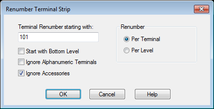

Renumber Terminals
  1. Select which terminal strip to edit on the Terminal Strip Selection dialog box and click Edit.
  2. Select the Terminal Strip tab.
  3. Select the terminal rows you wish to renumber.
  4. Click .
  5. Enter a starting number.
  6. If any multi-level terminals are part of the selection, select whether to renumber by:
    • Terminal - renumbers in order of the terminal listing including multiple levels.
    • Level - renumbers all single-level terminals and the first level on multi-level terminals, then the second level, and so on.
  7. Check any other options as necessary.
  8. Click OK.

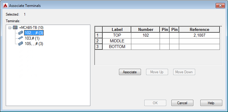

Associate Terminals for Multi-Level Terminals
  3. If all of the terminals you wish to associate are single level terminals do one of the following:
    • Modify the terminal properties of one of the terminals defining it as multi-level.
    • Assign a catalog value for a multi-level terminal.
  4. Select the terminal rows you wish to assign to specific levels on the multi-level terminal.
  5. Click in the Multi-Level section.
  6. Select the terminal you want to push the selected rows into.
  7. Click Associate.
  8. To move a terminal from one level to another, select the row and click Move Up or Move Down.
  9. Click OK.

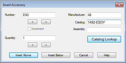

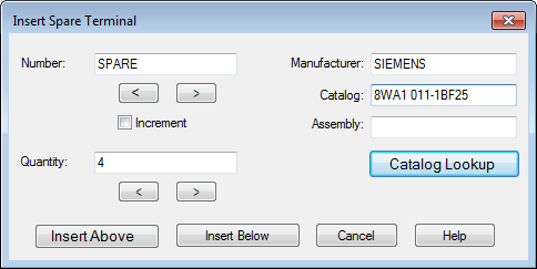

Add Spare Terminals and Accessories
  3. Select the row where you want to insert the spare above or below.
  4. Click in the Spare section to insert a spare.
  5. Enter the number or text to use for the first spare terminal. If you do not select to increment the number, the value is used for all the spares added during this operation.
  6. Enter the quantity of spares to add.
  7. Assign a catalog value if necessary.
  8. Click to Insert Above or Insert Below the selected row.
  9. Select the row where you want to insert the accessory above or below.
  10. Click in the Spare section to insert an accessory.
  11. Enter the number or text to use for the accessory.
  12. Enter the quantity of accessories to add.
  13. Assign a catalog value if necessary.
  14. Click to Insert Above or Insert Below the selected row.
  15. Click OK to exit the terminal strip.

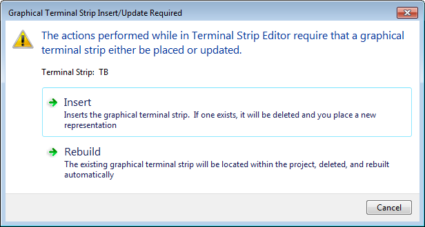

    Note: A graphical terminal strip must be inserted or rebuilt, otherwise spare terminals and accessories are not maintained.
