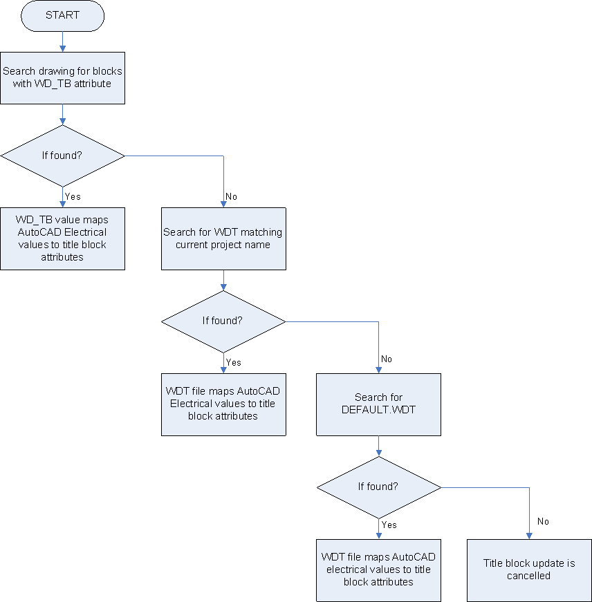

AutoCAD Electrical can link project description lines and some of the drawing properties to attributes on the drawing title block . There are two methods:
During a title block update, AutoCAD Electrical follows this sequence to determine which method to use.
