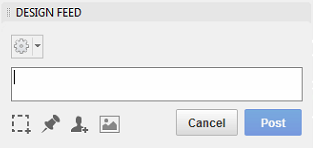

Design Feed and AutoCAD Electrical
Design Feed provides a way of entering collaborative posts about a drawing in both real-time and asynchronous modes. Posts appear with the related drawings on the desktop, on the web, and across mobile devices.
When you create a post, you use the Design Feed palette to enter a text message and/or attach an image that conveys what you want to express about the drawing to which the post is attached. You can link the original post to a point, area, or object in the drawing. You can also tag colleagues and clients to notify them of your post. Notifications are sent to them through email and within AutoCAD Electrical.
Once you have committed a post, it is uploaded to Autodesk 360 with the drawing, along with any images you've attached. From there, colleagues and clients can access it and post their replies. Replies are listed as "children" below the original "parent" post. If there are no replies, the original post can stand by itself.
When the questions in a post and its replies are no longer active, you can resolve the thread to hide it from the Design Feed.
