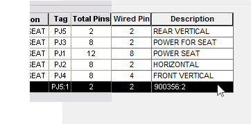

- The connector you added in Inventor is listed in the Connector Selection dialog box. Select the row for the connector.

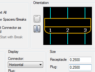

- At the bottom of the dialog box, click Details.
- On the connector display menu, click Horizontal.
The display in the dialog box switches to horizontal.
