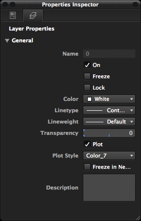

Current Properties
Layer Properties
Summary

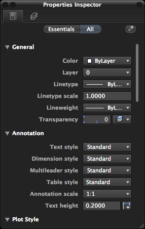

Current
Displays the properties for the current drawing or selected objects.
Layer
Displays the properties for the layer selected in the Layer list of the Layers palette.
Object Type
Displays the type of objects that are selected and filters which objects you are modifying.
Essentials
Displays the most commonly edited or viewed properties for the current drawing or selected objects.
All
Displays all the properties associated with the current drawing or the selected objects.
Match Properties
Applies the properties of a selected object to other objects.
Drawing/Objects/Layer Properties
Displays a list of available properties that can currently be edited. The list of properties show is based on the following conditions:
  • No objects selected in the current drawing. Drawing specific properties are displayed.
  • Objects selected in the current drawing. Properties common to all selected objects are displayed.
  • Layer selected from the Layer list in the Layers palette. Layer properties are displayed.
