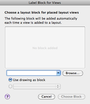

Label Block for Views Dialog Box
Adds a new label block for use in the current project.
List of Options
The following options are displayed.
Preview
Displays a preview image when a block is selected.
Drawing File Location
Specifies the path and name of a drawing (DWG) file or the name and path of a drawing template (DWT) file to be used as the source of a block definition.
Click Browse to display the Select Drawing dialog box and select the drawing file to use.
Note: The locations of the last five most recently selected drawing files are retained in the drop-down list.
Use Drawing as Block
Use the entire specified drawing or drawing template file as the block definition.
Choose Block in the Drawing File
Use a selected block definition from the specified drawing or drawing template file.
