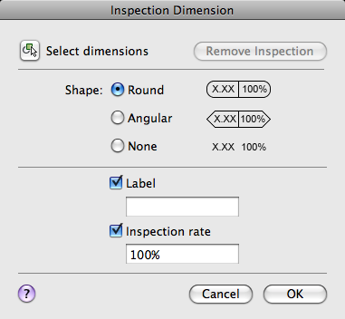

Inspection Dimension Dialog Box
Allows you to add or remove an inspection dimension from selected dimensions.
Summary
Use the Shape and Inspection Label/Rate settings to the appearance of the frame of the inspection dimension and the inspection rate value.
List of Options
The following options are displayed.
Select Dimensions
Specifies the dimensions that an inspection dimension should be added to or removed from.
Remove Inspection
Removes the inspection dimension from the selected dimension.
Shape
Controls the shape of the frame that is drawn around the label, dimension value, and inspection rate of the inspection dimension.
Round
Creates a frame with semi-circles on the two ends; the fields within the frame are separated by vertical lines.
Angular
Creates a frame with lines that form a 90-degree angle on the two ends; the fields within the frame are separated by vertical lines.
None
Specifies that no frame is drawn around the values; the fields are not separated by vertical lines.
Label/Inspection Rate
Specifies the label text and inspection rate for an inspection dimension.
Label
Turns the display of the label field on and off.
Label Value
Specifies the label text.
The label is displayed in the leftmost section of the inspection dimension when the Label check box is selected.
Inspection Rate
Turns the display of the rate field on and off.
Inspection Rate Value
Specifies how frequently a part should be inspected.
The value is expressed as a percentage, and the valid range is 0 to 100. The inspection rate is displayed in the rightmost section of the inspection dimension when the Inspection Rate check box is selected.
