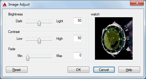

Image Adjust Dialog Box
Controls how the image is displayed by adjusting the brightness, contrast, and fade settings of the selected image.
Summary
Adjusting these values changes the display of the image but does not change the image file itself.
List of Options
The following options are displayed.
Brightness
Controls the brightness, and indirectly the contrast, of the image. The greater the value, the brighter the image and the more pixels that become white when you increase contrast.
Contrast
Controls the contrast, and indirectlyd the fading effect of the image. The greater the value, the more each pixel is forced to its primary or secondary color.
Fade
Controls the fading effect of the image. The greater the value, the more the image blends with the current background color. A value of 100 blends the image completely into the background. Changing the screen background color causes the image to fade to the new color. In plotting, the background color for fade is white.
Image Preview
Displays a preview of the selected image. The preview image updates dynamically to reflect changes to the brightness, contrast, and fade settings.
Reset
Resets values for brightness, contrast, and fade to default settings (50, 50, and 0, respectively).
