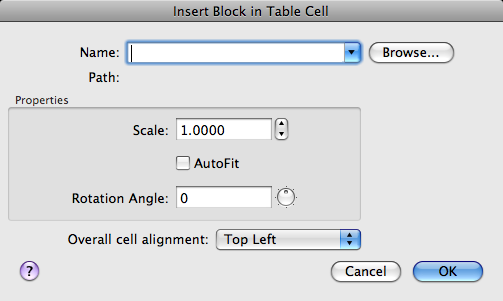

Insert Block in Table Cell Dialog Box
Specifies options for inserting a block in a table cell.
List of Options
The following options are displayed.
Name
Specifies the block reference to insert.
Browse
Displays the Select Drawing File dialog box. Select the drawing file to insert as a block reference.
Path
Displays the location of the drawing file selected in the Select Drawing File dialog box.
Scale
Specifies the scale for the block reference. Enter a value or select AutoFit to scale the block to fit in the selected cell.
AutoFit
Controls if the block reference should be scaled to fit in the select table cell, or if the height and width of the table cell should be adjusted to fit the block reference being inserted.
Rotation Angle
Specifies a rotation angle for the block.
Overall Cell Alignment
Specifies alignment for the block in the table cell. The block is middle-, top-, or bottom-aligned with respect to the top and bottom borders of the cell. The block is center-, left-, or right-aligned with respect to the left and right borders of the cell.
