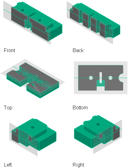

Aligns the section object to an orthographic orientation relative to the UCS.
A section object that contains all 3D objects is created with the specified orientation relative to the UCS (not the current view). This option creates a section object in the Section Plane state with live sectioning turned on.
