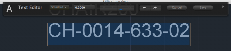

ATTIPEDIT (Command)
Changes the textual content of an attribute within a block.
Summary
If you select a single-line attribute, displays the In-Place Text Editor without the ruler. Right-click to display options. Selecting a multiple-line attribute displays the In-Place Text Editor with the ruler.
Depending on the setting of the ATTIPE system variable, the right-click menu changes the formatting and editing operations available for compatibility with previous AutoCAD for Mac releases.
Note: Not all MTEXT formatting options are available for multiline attributes even with the full In-Place Editor.
List of Prompts
The following prompts are displayed.
Select attribute to edit: Select an attribute within a block
