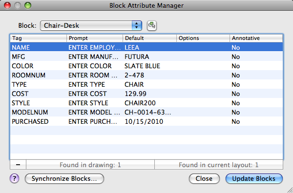

Block Attribute Manager
Manages the attribute definitions for blocks in the current drawing.
Summary
You can edit the attribute definitions in blocks, remove attributes from blocks, and change the order in which you are prompted for attribute values when inserting a block.
Attributes of the selected block are displayed in the attribute list. By default, Tag, Prompt, Default, Mode, and Annotative attribute properties are displayed in the attribute list. For each selected block, a description below the attribute list identifies the number of its instances in the current drawing and in the current layout.
You can specify which attribute properties you want displayed in the list by right-clicking over the attribute headers and choosing the ones to display.
Double-click an attribute to display the Attribute Editor dialog box, where you can modify attribute properties.

Select Block
You can use your pointing device to select a block from the drawing area. When you choose Select Block, the dialog box closes until you select a block from the drawing or you cancel by pressing ESC.
If you modify attributes of a block and then select a new block before you save the attribute changes you made, you are prompted to save the changes before selecting another block.
Block
Lists all block definitions in the current drawing that have attributes. Select the block whose attributes you want to modify.
List of Attributes
Displays the properties of each attribute in the selected block.
Remove
Removes the selected attribute from the block definition. If Synchronize Blocks is clicked and then Synchronize is clicked in the Synchronize Blocks dialog box, the attribute is removed from all instances of the block in the current drawing.
Found in Drawing
Reports the total number of instances of the selected block in the current drawing.
Found in Current Layout
Reports the number of instances of the selected block in the current model space or layout.
Synchronize Blocks
Updates all instances of the selected block with the attribute properties currently defined. This does not affect any values assigned to attributes in each block.
Update Blocks
Applies the changes made and closes the dialog box open.
