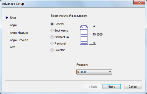

Advanced Setup Wizard
Defines the units, angle, angle measure, angle direction, and area of your new drawing.
Summary
List of Options
The following options are displayed.
The Advanced Setup wizard contains five pages: Units, Angle, Angle Measure, Angle Direction, and Area. As you work in this wizard, choose Back and Next to navigate between pages; choose Finish on the last page to close the wizard and create the new drawing with the settings you specified.
You can later change units, angle, angle measure, and angle direction using the UNITS command, and you can change area using the LIMITS command.
Units
Indicates the unit format and precision. The unit format is the format in which you enter and in which the program displays coordinates and measurements. The Units page of the Quick Setup wizard includes the same formats. See Specify Units and Unit Formats for more information.
The unit precision specifies the number of decimal places or the fractional size for displaying linear measurements.
