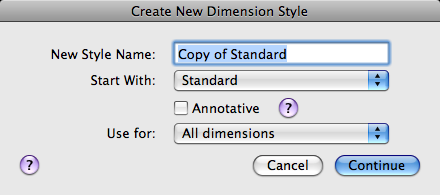

Create New Dimension Style Dialog Box
Names the new dimension style, sets the style on which to start the new one, and indicates the dimension types to which you want the new style to apply.
List of Options
The following options are displayed.
New Style Name
Specifies the new dimension style name.
Start With
Sets a style to use as a basis for the new one. For the new style, you change only the properties that differ from the properties you start with.
Annotative
Specifies that the dimension style is annotative. Click the information icon to learn more about annotative objects.
Use For
Creates a dimension substyle that applies only to specific dimension types. For example, you could create a version of the STANDARD dimension style to be used only for diameter dimensions.
Continue
Displays the New Dimension Style dialog box, in which you define the new dimension style properties.
