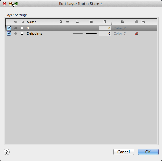

Edit Layer State Dialog Box
Modifies the selected layer state.
Summary
Displays all the layers and their properties that are saved in the selected layer state.
List of Options
The following options are displayed.
Layer List
Displays a list of layers in the selected layer state and their properties.
