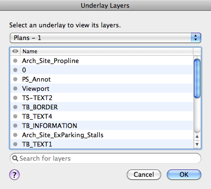

Underlay Layers Dialog Box
Controls the display of layers in a PDF underlay.
List of Options
The following options are available in this dialog box.
Reference Name
Select the reference whose layers you want to manage.
Layer List
Visible
Displays the current visibility state for each layer in the selected underlay. When a layer is on it is visible and available for plotting. When a layer is off, it is invisible and not plotted.
Click in this column to toggle the current visibility for the layer listed in the Name column.
Name
Displays the names of all the available layers in the selected underlay.
Search for Layers
Filters the layer list by name quickly as you enter characters. This filter is not saved when you close the Underlay Layers dialog box. You can also search using wild cards.
