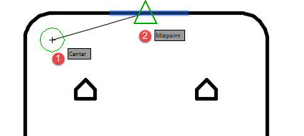

Object snaps provide a way to specify precise locations on objects whenever you are prompted for a point within a command.
For example, you can use object snaps to create a line from the center of an arc to the midpoint of another line.
You can specify an object snap whenever you are prompted for a point. By default, a marker and a tooltip are displayed when you move the cursor over an object snap location on an object. This feature, called AutoSnap ™ , provides visual confirmation that indicates which object snap is in effect.

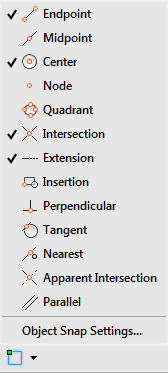

Use Running Object Snaps
If you need to use one or more object snaps repeatedly, you can turn on running object snaps, which persist through all subsequent commands. For example, you might set Endpoint, Midpoint, and Center as running object snaps.
Tip: If several running object snaps are turned on, more than one object snap may be eligible at a given location. You can press Tab to cycle through the possibilities before you specify the point.
