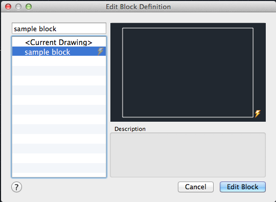

Edit Block Definition Dialog Box
Select from a list of block definitions that are saved in the drawing to edit in the Block Editor. You can also enter a name for a new block definition to create in the Block Editor.
Summary
When you click Edit Block, the Edit Block Definition dialog box closes, and the Block Editor is displayed.
List of Options
The following options are displayed.
Block to create or edit
Specifies the name of the block to edit or create in the Block Editor. If you select <Current Drawing>, the current drawing is opened in the Block Editor.
Name List
Displays a list of block definitions that are saved in the current drawing. When you select a block definition from the list, the name is displayed in the Name box.
When you click Edit Block, this block definition is opened in the Block Editor. When you select <Current Drawing>, the current drawing is opened in the Block Editor.
Preview
Displays a preview of the selected block definition. A lightning bolt icon indicates that the block is a dynamic block.
Description
Displays the description of the selected block definition.
