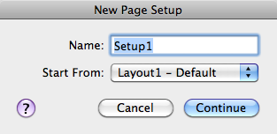

New Page Setup Dialog Box
Specifies a name for the new page setup, as well as the page setup to use as a starting point.
List of Options
The following options are displayed.
New Page Setup Name
Specifies the name for the new page setup.
Start From
Specifies a page setup to use as a starting point for the new page setup. When you click Continue, the Page Setup dialog box is displayed with the settings of the selected page setup, which you can modify as necessary.
<Default Output Device>
Specifies that the default output device is set as the printer in the new page setup.
