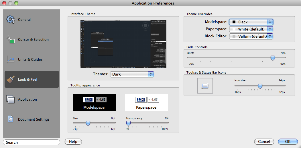

Look & Feel Tab (Application Preferences Dialog Box)
Controls the appearance of the program user interface.
List of Options
The following options are displayed.
Interface Theme
Defines the color scheme for the user interface.
Themes
Controls which theme to apply to elements such as the status bar, palettes, and the drawing windows. You can choose from a Dark or Light theme.
Tooltip Appearance
Controls the appearance of drafting tooltips.
Size
Specifies a size for tooltips. The default size is 0. Use the slider to make tooltips larger or smaller.
Transparency
Controls the transparency of tooltips. The lower the setting, the less transparent the tooltip. A value of 0 sets the tooltip to opaque.
Interface Overrides
Overrides used to fine tune the colors applied to the background of the drawing area.
Model Space
Specifies the background color of the drawing area when the Model layout is active. Choose a color or Select Color to specify one of the non-standard colors.
Paper Space
Specifies the background color of the drawing area when a named (paper space) layout is active.
Block Editor
Specifies the background color of the drawing area when the Block Editor environment is active.
Fade Controls
Controls the fading intensity value for xrefs.
Xrefs
Controls the dimming for all DWG xref objects. (XDWGFADECTL system variable)
This option only affects the display on the screen. It does not affect plotting or plot preview.
Tool Set & Status Bar Icons
Controls the size of the icons used in parts of the user interface.
Icon Size
Specifies the size of the icons displayed on the Tool Sets palette and status bar. (ICONSIZE system variable)
