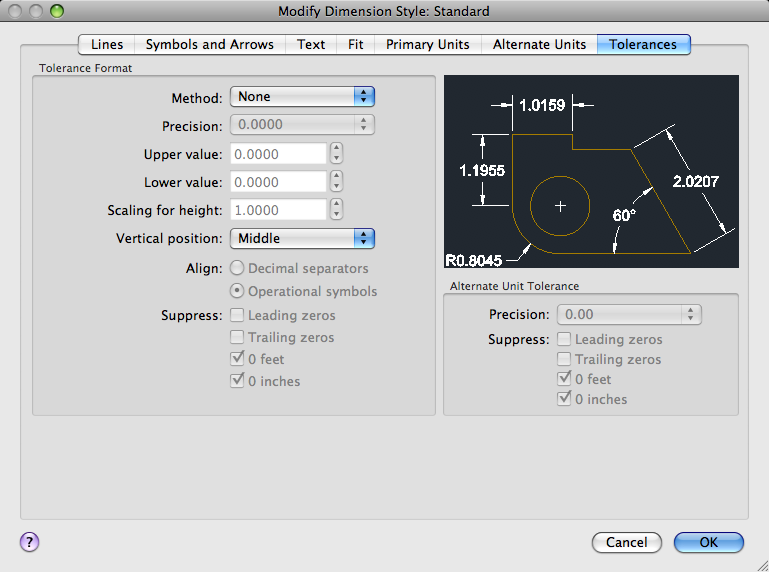

Specifies the display and format of dimension text tolerances.
The following options are displayed.
Controls the tolerance format.
Sets the method for calculating the tolerance. (DIMTOL system variable)
Sets the number of decimal places. (DIMTDEC system variable)
Sets the maximum or upper tolerance value. When you select Symmetrical in Method, this value is used for the tolerance. (DIMTP system variable)
Sets the minimum or lower tolerance value. (DIMTM system variable)
Sets the current height for the tolerance text. The ratio of the tolerance height to the main dimension text height is calculated and stored in the DIMTFAC system variable.
Controls text justification for symmetrical and deviation tolerances.
Controls the alignment of upper and lower tolerance values when stacked
Values are stacked by their decimal separators.
Values are stacked by their operational symbols.
Controls the suppression of leading and trailing zeros and of feet and inches that have a value of zero. (DIMTZIN system variable)
Suppresses leading zeros in all decimal dimensions. For example, 0.5000 becomes .5000.
Suppresses trailing zeros in all decimal dimensions. For example, 12.5000 becomes 12.5, and 30.0000 becomes 30.
Suppresses the feet portion of a feet-and-inches dimension when the distance is less than 1 foot. For example, 0'-6 1/2" becomes 6 1/2".
Suppresses the inches portion of a feet-and-inches dimension when the distance is an integral number of feet. For example, 1'-0" becomes 1'.
Formats alternate tolerance units.
Displays and sets the number of decimal places. (DIMALTTD system variable)
Controls the suppression of leading and trailing zeros and of feet and inches that have a value of zero. (DIMALTTZ system variable)
Displays sample dimension images that show the effects of changes you make to dimension style settings.
