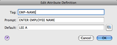

Edit Attribute Definition Dialog Box
Edits an attribute text object.
List of Options
The following options are displayed.
Tag
Specifies the attribute tag, which identifies the attribute in the drawing. The tag can contain exclamation marks (!). The case change is not immediately displayed in the tag field.
Prompt
Specifies the attribute prompt that is displayed when you insert a block containing this attribute definition.
Default
Specifies the default attribute value.
To use a field as the value, right-click and click Insert Field on the shortcut menu to display the Insert Field dialog box.
