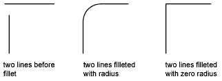

To Set the Fillet Radius
The fillet radius is the radius of the arc that connects filleted objects. Changing the fillet radius affects subsequent fillets. If you set the fillet radius to 0, filleted objects are trimmed or extended until they intersect, but no arc is created.
Tip: You can press and hold Shift while selecting objects to override the current fillet radius with a value of 0.
  1. Click ModifyFillet.
  2. Enter r (Radius).
  3. Enter the fillet radius.
