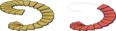

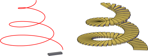

In path arrays, items are evenly distributed along a path or a portion of a path.
A path can be a line, polyline, 3D polyline, spline, helix, arc, circle, or ellipse.

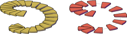

Array Item Distribution
The distribution of items along the path can be measured or divided.
