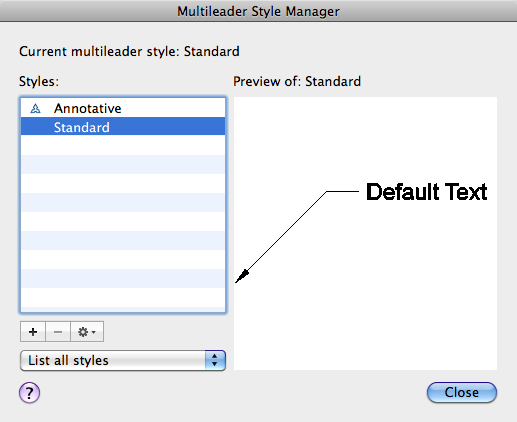

Multileader Style Manager
Creates and modifies styles that you can use to create multileader objects
Summary
Sets the current multileader style and creates, modifies, and deletes multileader styles.
The appearance of multileaders is controlled by multileader styles. These styles specify formatting for landing lines, leader lines, arrowheads, and content.
List of Options
The following options are displayed.
Current Multileader Style
Displays the name of the multileader style that is applied to multileaders you create. The default multileader style is Standard.
Styles
Displays a list of multileader styles. The current style is highlighted.
List
Controls the contents of the Styles list. Click All Styles to display all multileader styles available in the drawing. Click Styles In Use to display only the multileader styles that are referenced by multileaders in the current drawing.
Preview Of
Displays a preview image of the style that is selected in the Styles list.
New (+)
Displays the Create New Multileader Style dialog box, in which you can define new multileader styles.
Delete (-)
Deletes the multileader style selected in the Styles list. A style that is being used in the drawing cannot be deleted.
Options
Manages the multileader styles in the list.
Set Current
Sets the multileader style selected in the Styles list as the current style. All new multileaders are created using this multileader style.
Modify
Displays the Modify Multileader Style dialog box, in which you can modify multileader styles.
Rename
Edits the name of the style selected in the list.
