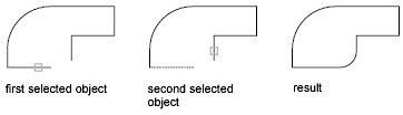

In the example, an arc is created that is tangent to both of the selected lines. The lines are trimmed to the ends of the arc. To create a sharp corner instead, enter a radius of zero.

Select second object or shift-select to apply corner: Use an object selection method or hold down Shift and select an object to create a sharp corner
If you select lines, arcs, or polylines, their lengths adjust to accommodate the fillet arc. You can hold down Shift while selecting the objects to override the current fillet radius with a value of 0.

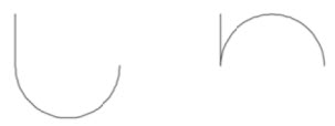

If the selected objects are straight line segments of a 2D polyline, they can be adjacent or separated by one other segment. If they are separated by another polyline segment, FILLET deletes the segment that separates them and replaces it with the fillet.

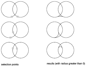

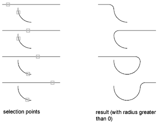

More than one fillet can exist between arcs and circles. Select the objects close to where you want the endpoints of the fillet.
FILLET does not trim circles; the fillet arc meets the circle smoothly.

If one arc segment separates two line segments that converge as they approach the arc segment, FILLET removes the arc segment and replaces it with a fillet arc.
You can press the Ctrl key while creating a polyline arc to draw the polyline arcs in the opposite direction.
